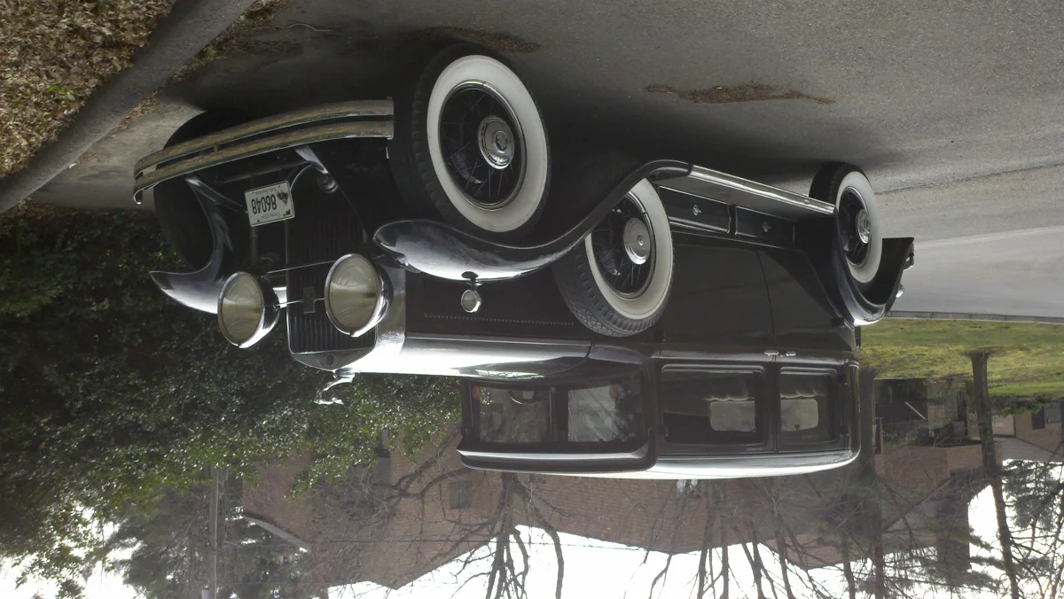

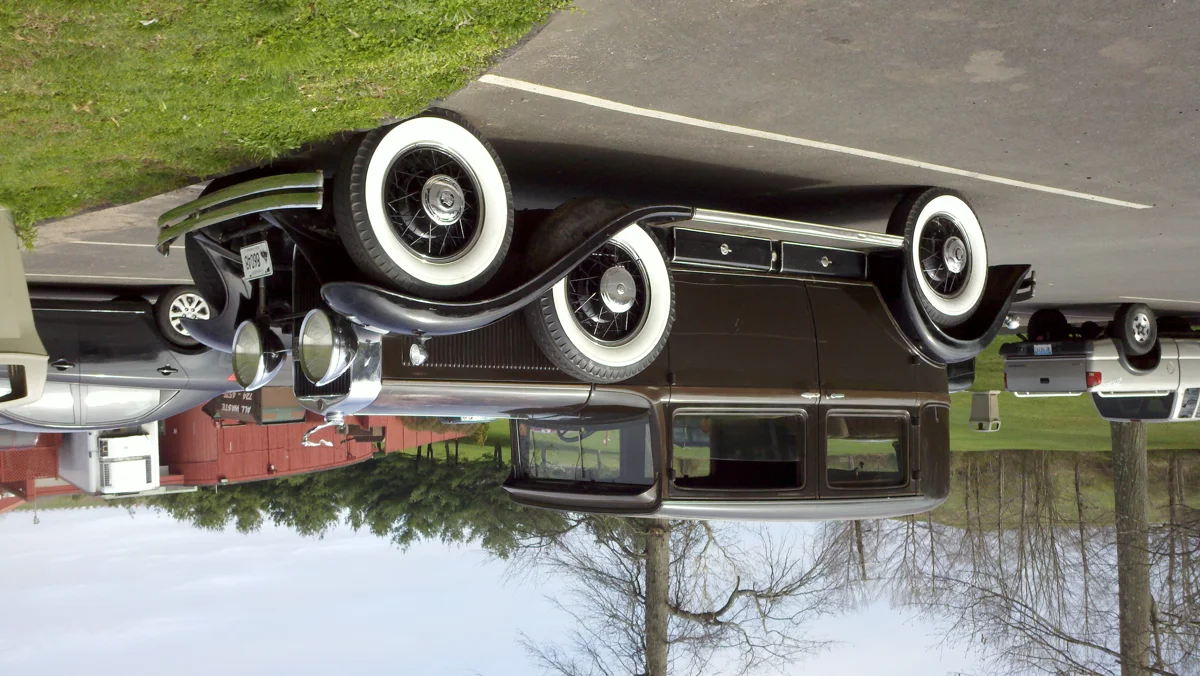

Martin's car is up and running strong. I spent a few hours with him the other day and had a chance to drive his car. It's a great Caddy, and I'm sure we will see lots of it this year. Post a few photos Martin! Ed
I drove 30miles this morning just to get a cup of coffee, great drive. The car runs great and gets more fun by the mile. I thought once I got it going I would start to do other repairs but I really don't want to stop driving it now. Cruises at a bit more than 40 very comfortable but when you engage the overdrive it really moves out and can easily do 65 with what seems like pretty low RPMs. Still needs work but it’s a fun car to take out on the road, nice brakes too.
I could not have done this without the help of Ed Minnie, he really, really knows his stuff.
Thanks Ed, you need to come back soon for some finale adjustments!!
More pictures coming soon, one is early this morning with fog and the other is at the coffee place, I will get other angles soon.
